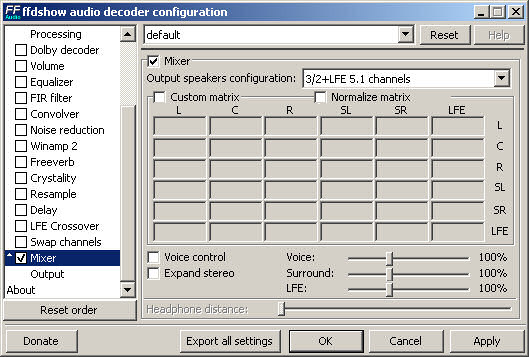

The next step is to set ffdshow's mixer to output in the same number of channels, to do this scroll down the left pane of the ffdshow configuration window and select "Mixer", the window should appear as shown in the second picture.
Now in the "Output speakers configuration" drop down box select "Same as input".
A number of other options such as "Custom matrix", "Normalize matrix", "Voice control" and "Expand stereo" should be unchecked.
You should now be able to enjoy AC3, DTS, OGG mutli channel files in full.
